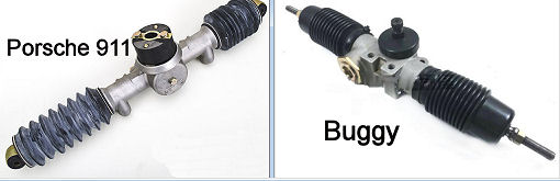

I am sorting out/designing/trialing steering systems, something that literally has to be done from scratch, and that I always knew was going to be one of the most difficult steps.
Basically, there is no suitable steering racks for a central seat car, or the ones that are suitable, like a Porsche 911, are way out of price range for the project. Off road buggy ones are not suitable, just not made well enough, primarily for golf carts or small off road buggies. The proper race buggy racks are $500 or so.

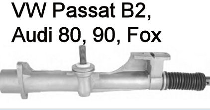

I have a possible solution, an older VW/Audi rack that is still widely available as it was used in China up until a few years ago, made literally in the millions, will buy one tomorrow and see how it shapes up ..
