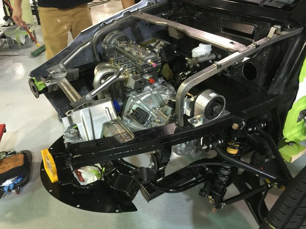

For those of you who are all about efficiency and power, here’s a great shot of the E-Series powertrain pictured in mid-installation, in position in the engine cradle. Note the engine stabilizing bar from the front support awaiting connection and the transmission mount on top of the frame rail, just above and to the left of the coil-over shock assembly.
The E-Series powertrain pictured in mid-installation, in position in the engine cradle.

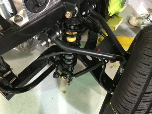

When it comes to the E-Series’ handling, it’s all about the suspension. This is the left-front suspension of the vehicle being assembled at the Pilot Operations Center. As we’ve mentioned previously, the E-Series has an independent suspension up front, consisting of unequal upper and lower control arms, incorporating a coil-over shock absorber design, which provides excellent handling and stability.
The left-front suspension of the first E-Series vehicle being assembled at the Pilot Operations Center.

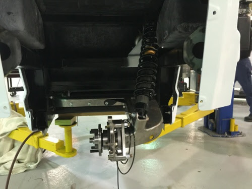

The E-Series’ swing-arm rear suspension also has been installed, with the ABS system’s electrical connection ready to be connected in this picture. Notice the multi-toothed ABS tone ring that is protected in the middle of the swing-arm assembly. When mounted, the E-Series’ rear wheel also helps provide protection for the tone ring.
The E-Series swing-arm rear suspension during installation.

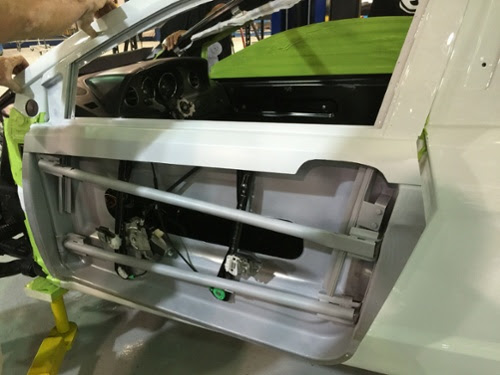

The driver’s door, which at this point has not yet had the door skin installed, shows both the power window motor and regulator hardware in place. It also shows the impact beams, which tie the hinge pillar to the B-pillars. The impact beams are designed to work as a system and play a strong role in absorbing energy. In the event of an impact, they are designed to deflect or catch and minimize intrusion and transfer energy load to other parts of the vehicle.
The E-Series driver’s door, prior to the door skin being installed.

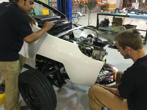

Elio Motors technicians position the E-Series’ front fender for attachment during vehicle assembly. The E-Series’ body panels are made from Sheet Molding Composite.
An E-Series front fender is attached during vehicle assembly.

That lower front A-arm is a whole new design; very different from the P-5
The upper is now tubing rather than flat stamped? That's new too.
The lower is still stamped, welded box.
I think that's the first good picture of the rear swing arm; it is beefy. :thumb:
And the offset on the rear tire looks like it will be a little odd

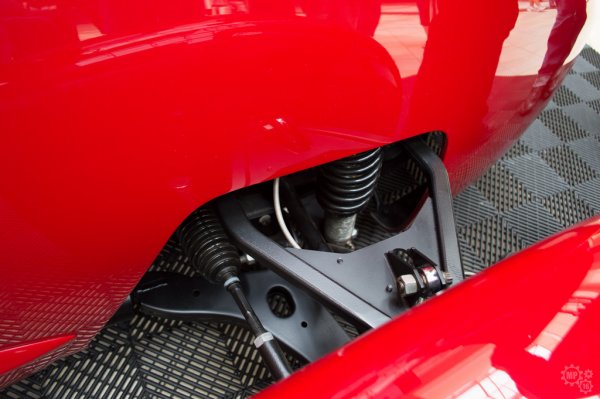

P-5 Pic
Better angle
That is a sloppy weld. :(

Lower one is the same as the P-5
Gonna have to disagree with you on this one, I'm seeing two different designs. Both mount points are behind the shock on the P5. Front and rear mount points on the E1.
Edit: scratch that. Was seeing something else. But it still looks different to me...:noidea:
