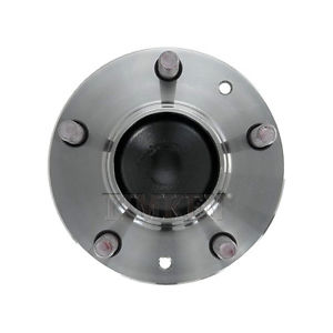

  3. Rear hub is... odd. Why didn't they use an off-the-shelf hub with internal ABS reluctor? Why the Rube-Goldberg contraption? Hubs like this can handle 2000 lb, have internal sealed ABS sensors, and cost $75 retail for one:

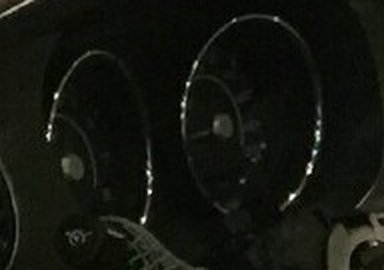

  9. Gauges are conventional! :eek: :eek: :eek: :eek: :eek: :eek:

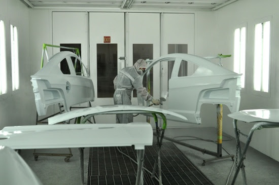

Is it my imagination, or does the right side panel (it's on the left side of this picture) show a carve out of some sort for the side exhaust pipe? Does this mean there won't be the "bulge" or it might be significantly less bulgy than on the P5? It would be great if it had a more purposefully designed-in look rather than an afterthought look.
The first panel in the foreground (the long one with a hole on the left edge is the "bulge" from the looks of it; it didn't shrink very much.
Gonna have to disagree with you on this one, I'm seeing two different designs. Both mount points are behind the shock on the P5. Front and rear mount points on the E1.
Edit: scratch that. Was seeing something else. But it still looks different to me...:noidea:
I think what you are seeing is the right hand side on the P5 and the left hand side on the E1. That's why the lower A arm looks different in the two pictures. Upper A arm is definitely different.
