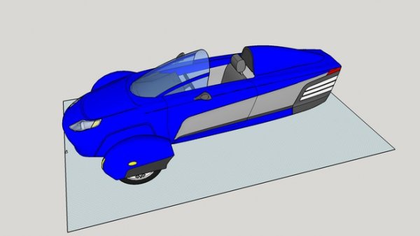

Great points, and I think you're right about the single panel roof making a full cabrio top a better option than the sunroof-only approach. On the collapsible ribs, again good point. I was thinking some judicious and innovative application of origami folds might help. Worth a try on paper, at least. Good luck!
I was thinking of using chevron stitches to delineate "panels". The roof would technically be a single piece of cloth, but you use stitchest to encourage the roof to fold in a particular way as it is opened. I'll see if I can't make a prototype during my lunch break today (I work with an industrial sewing machine for my job).

....... I assumed most people would be removing the stock roof panel and installing the cabriolet top themselves. That way, during the cold months you could simply put the hard-top back onto it. The Elio already uses a panel-on-frame design made to facilitate easy panel replacement, so I see no challenge to easy swap-outs.
Actually, I think the approach you suggest would be harder. To make a sunroof while leaving the rear hatch intact, you would need to permanantly alter the existing roof panel. While I'm sure that would be an option for some people, I can't imagine taking a hacksaw to MY Elio. I think a simple one-piece, "no permanent alterations required" approach would be both easier to engineer and more attractive to the aftermarket.

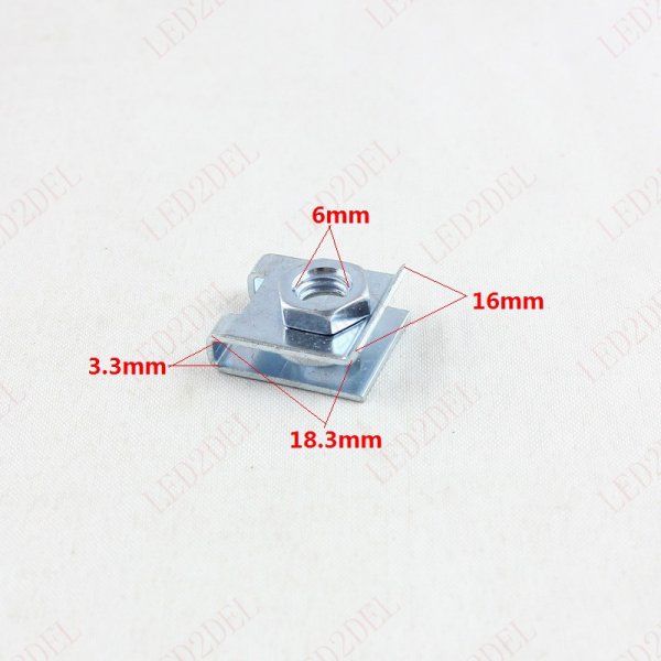

Don't forget the blind structural nuts along the frame. You should be able to use those to secure anytime hardware you'd need.
