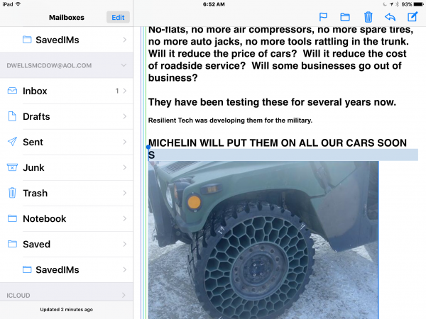

By the time that we get our Elio's, we might not need tire sensors. These tires should be in production for cars in Aug. 2017!
10,995
I like those, but always wondered about ice, snow, mud, etc getting between the tread and rim and what kind of havoc that would wreak on the tire balance and handling. Cool idea though. Maybe someday.
