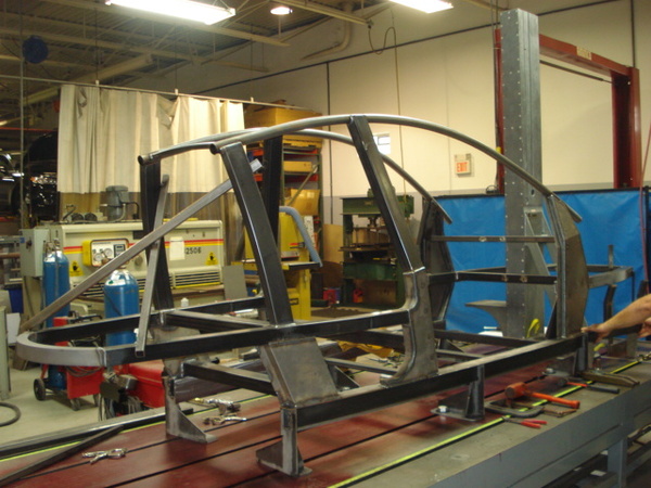

Getting in and out of the rear seat in the P4 is no mean feat. I propose that for future models, EM cut a rear door on the opposite side of the driver's door. With doors on opposite sides, you don't need a door post. One problem: The gas cap is in the way over on that side.
It would have to be a completely new chassis as there is no room for such a door in the current chassis. Behind where the main door would be on either side is a key chassis element which adds a lot of structural integrity to the entire chassis and even protects the fuel cell which is located in the base of this element under the passenger seat.
We have to treat this vehicle as we would any coupe in that climbing into the back seat does take a little bit more work. However, one thing that will happen is that the drivers seat belt will move to the non door side which will help a little bit as the passenger will not have to climb over and around the seatbelt as in the current prototypes.
So G1, the front door can be either side, left or right hand drive?
