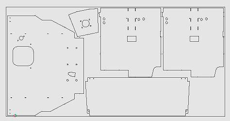

Just finished the cnc file for the new firewall, hope to get it cut and folded tomorrow, or the day after at most.
Big job to fit it, all the old stuff gets cut out, hope it cools down a bit in the next few days.
I thought I was going to need 2 x sheets of metal, but as you can see, I just squeezed the 4 items onto one sheet, pleased about that.

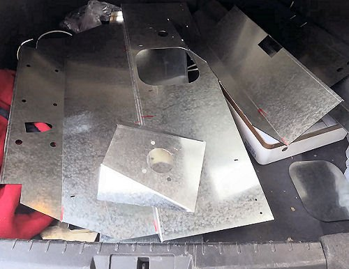

.. and a trunk full of lasered and folded firewall parts.
I had a scare for a moment, folding was the last thing today, and still in the car for tomorrow, but looking at the picture here, there was an optical illusion that had me running out to the car to check it, but all good.

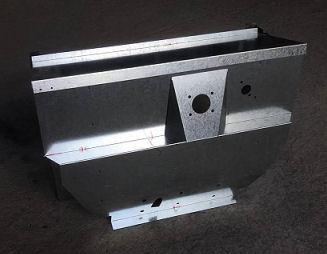

I had to go back to the fold shop this morning and adjust my silly mistake yesterday, luckily it was nothing more than simply add more bend to 2 underbent bends, and it cost me 3 ice creams for the adjustment.
Just loosely sitting on the floor to give one an idea of what it is, very happy the way it's going, and very happy it's all cut from just the one sheet (1M x 2M or 4' x 8'), and 13 of the 16 bends are at 90 degrees.
