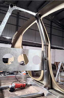

Not the best picture sorry, but the B pillar is about perfect, bit of a hassle, but worth the end result, and production slated.
The plate with the big holes is just an alignment jig to square it all up.
That's 'A' and 'B' pillars set in stone, now onto 'C' ...

On the contrary, you've showed us the best angle shot and it fits like a glove! Well done.

I have put extra effort into it's positioning to make the rear open feel as open as possible with good forward vision.
Last thing wanted is a rear seat area that feels like climbing into a sarcophagus.

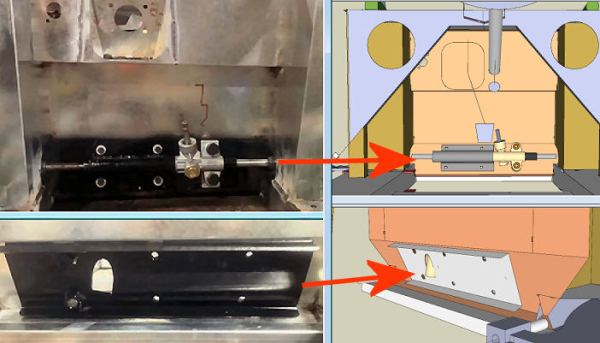

I want to do the rollbars, but that entails sealing down the dash panel making access to the footwell a little awkward, so instead today I finished mounting the steering rack proper.
I laser cut and folded some new mounts, and welded them for the left side of the rack mount, you can see it's locked down with 4 bolts now rather than 2,
... and I laser'd and folded a strengthening plate on the outside of the firewall. Simply a flat plate with 2 x 90 degree folds for strength.
Bit hard to see in the pictures as I painted it all to protect the large mating surfaces from rust, so the CAD drawings are included to explain it.
