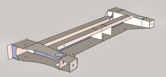

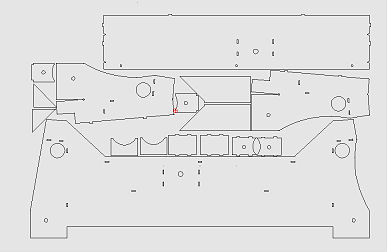

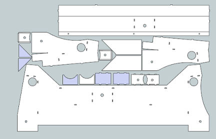

So finally decided on a crossmember design, finalised the layout in 3D, flattened it out, and tidied it up into 2D CAD for CNC laser cutting.
Hopefully the laser shop can do it tomorrow :-)

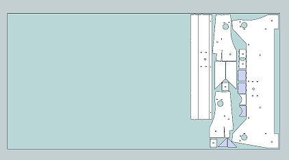

Curious if when you do the laser layout if you take into consideration the cut path? You obviously are trying to utilize the space well.
That's quite a loose nest, I get much tighter than that usually. Nesting is fun, it's a challenge, like a jigsaw puzzle. This is what it looks like on a 1000 x 2000mm/4 x 8ft sheet ..
The laser cut is less than 0.1mm/0.004" but occasionally they have a spit, and I don't know where the starting hole will be, it can be a bit messy sometimes, so I play it safe unless I need to utilise the whole sheet to avoid buying another.

is the crossmember design you've decided on available off the shelf or will you have to find a source to manufacture them for your assembly line
Mark BEX
Feb 2, 2021
1,190
4,745
Australia
It is a bespoke crossmember integral with the chassis.
a/ It is made as simply as possible from flat sheetmetal, laser or waterjet cut, with only 4 x 90 degree folds, that any small local engineering shop can replicate quickly if damaged. I am more than happy to supply them or the CNC file to cut them. I will show the building of the crossmember over the next few days.
I have no intention of holding people to ransom with bespoke parts as some companies do.
b/ It is designed around using standard 'off the shelf parts' such as lower control arms that are replaced often due to accident damage or ball joint/bush wear.
10-4 .... that makes good sense .... the car will have to have some unique parts .... designing those parts so as to accommodate as many as possible off the shelf parts as is possible.... nicely done

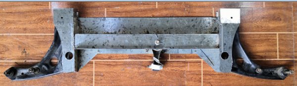

The parts for the crossmember were lasered today, so moving forward there now ...
