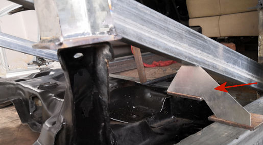

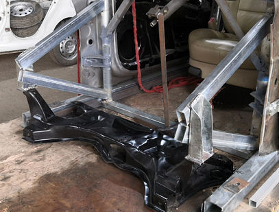

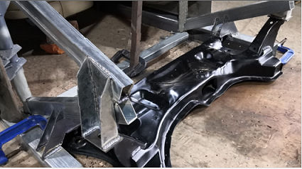

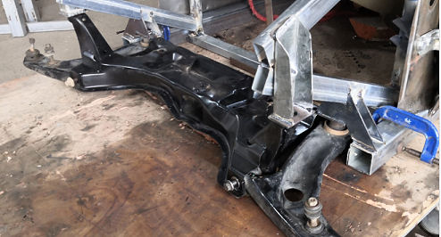

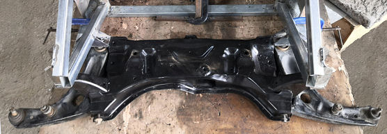

At this time I am going with the original crossmember so today I started to build some supporting framework to support it.
This is what happens sometimes developing prototype, it's a bit like a maze, you choose a path, and sometimes you hit a dead end.

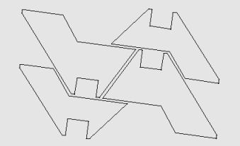

I made the basic frame, that may need to be altered depending on what framework is needed to mount the engine/gearbox, got some front mounts done, and started on the rear mountings. The template, red arrow, I bought home with me, and have made the .dxf file so tomorrow they will be laser cut.
