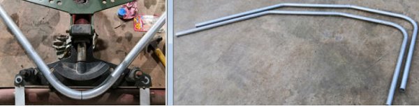

After a surprising amount of time to 'get it right', I feel I have nailed the side roll bars.
Though they look simple, the design affects related areas, the chassis, front and rear seating, even the fuel tank for which I do not want to make a bespoke fuel tank. The pickup, fuel level sender, pump and electrics all are specific to the engine, so I am very keen to use the original fuel tank.
Very pleased I have taught myself over the years to be able to bend even 100 degree bends in a pipe bender, which many say it can't be done without crushing or wrinkling the tube ...

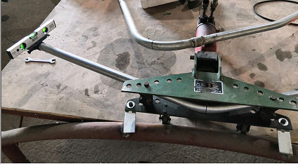

Because all 3 bends are on the same plane, I can use a little jig to hold a spirit level so all 3 bends really are on the flat plane. I also welded some tabs to a bench, and bolted the bender solid, only took me about 10 years to finally get around to it :-)

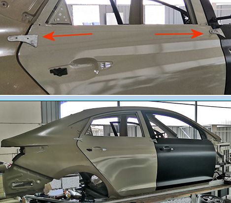

I had to lock the rear door into place with a couple of plates and rivets (red arrows), to line up the bodywork.
I am quite surprised how strong it all is, I was still expected flex, but it's remarkably solid considering there is little lateral support.

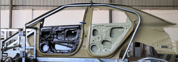

Roll bars looking good, it actually fits better than I hoped for after I locked the rear door into place, and peripheral items fitting as they should. Very happy about the '3 bends only' aspect of it.
Lookin good! That roll bar fits like a charm! I know the 3 bends in the same plane will be a benefit in production. Every bit helps!
hey…. You need to sell the rear door plates and rivets as a child proof lock option. ;) That’s at least a $150 add on in today’s market!
