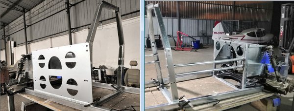

B Pillar was laser cut today, I took it to get folded, and started to look at the setup for issues.
You can see the jigging plate being used to line it up, using the door hinge holes, and I sat the side protection bars in looking for issues ... so far none.
As you will recall I had steel tube before, but this created alignment headaches, every bend can not be perfect, just a tenth of a degree difference in each of the total 10 bends in the 3 main roll hoops, and it ends up out of alignment very quickly.
The laser'ed parts are super accurate, and this makes the 2 main longitunal bars easier to be consistently placed accurately.

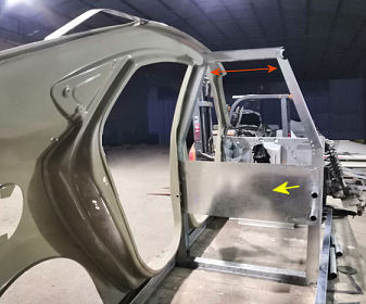

While quite happy with the B pillar design, as you can see with the red arrows, I can and will widen the top more to tuck it in closer to the bodywork. My fault, I played it too safe, worried about clearance issues, but pretty good overall first a first attempt, and you can see the lower half tucks in very nicely.
The panel with the yellow arrow, is an alignment jig, it doesn't stay there. It is the same alignment jig I use for the front firewall as well :-)
You can see the side impact bars here, they are in their final position.
