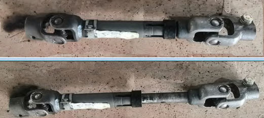

I've been working hard on steering wheel position, angle and height, and not only come up with a comfortable, adjustable solution I am very pleased with, but found when I got it into that position, I can use the donor car's steering shaft, and that is a win!
It's the proper steering shaft design for an adjustable column, as you can see in the picture, compressed and extended, as it needs to change length when the steering wheel is tilted, or adjusted in or out to suit different drivers.
So steering shaft is "off the shelf", and another production item resolved.

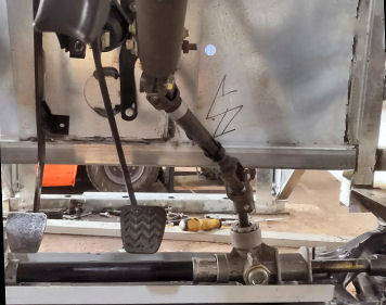

You can now see by the angles why I went to all the trouble to modify the steering rack for the pinion shaft to point inwards. The rack still isn't mounted properly, I have to wait for the laser shop to reopen in a few days for the brackets i need.
