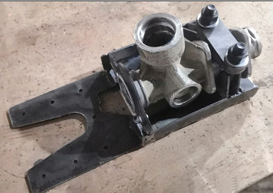

Today got all the bits I needed as I have had to make a mini subframe for the steering rack, was trying to avoid it, but actually turned out simpler and easier than expected.
This will allow me to assemble the steering rack on the bench first, then transfer it to, and simply bolt it onto the main crossmember.
Bolt it on tomorrow, then start looking at brakes, and getting it on it's wheels.

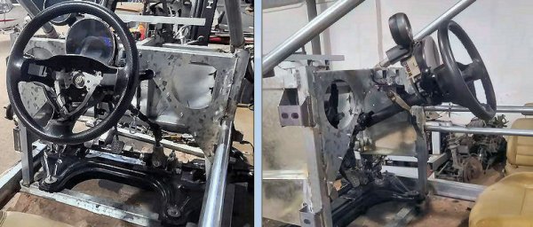

I know you're bored with steering updates, more me than you, but now it's pretty much all done, and that includes items such as driving position, and the ability to adjust the steering wheel up and down, and in and out to find a comfortable driving position.
I am happy it retains 90% "off the shelf" components, especially the telescopic steering shaft that allows for the steering wheel to be adjusted, that was a big win.
There's still some covers and better brackets to be made later, but the car could be driven with it as it stands.

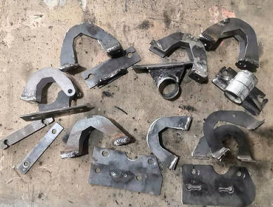

What an effort it's been though, here's just some of the left over test brackets changing heights, positions and pinion shaft rotation ..
