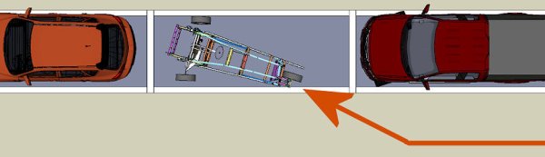

With a BEX type vehicle, even more advantages like driving forward into a car park in one movement.

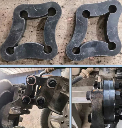

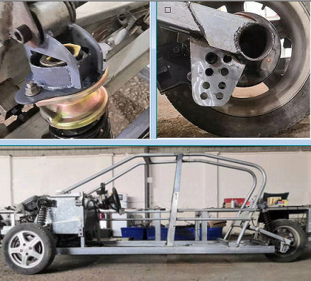

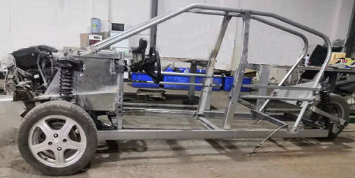

All valid points, thanks for the inputs, but I still got to build it!
The steering knuckles to suspension strut adapters worked out just great, bit scary when things work first time!

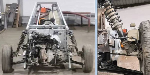

Ride height has been adjusted, couldn't be simpler, and now is sitting at 180mm or 7", but when radiator, A/C condenser, battery, wiring, washer bottle, bodywork and driver, etc, are added, should be down to 5", easy to adjust if need.
Notice rather than 4 separate holes, it's all one laser cut. They are 1/2" thick each, so no question of strength.

Mark,
Have you attempted a test body panel fitment to see how much the front is going to have to be modified to accommodate those struts? After seeing the front view it's got me curious.
