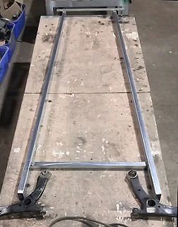

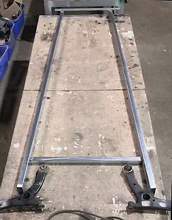

Made a start to laying new steel.
Will build a whole new frame as I want to keep the other car intact and drivable, don't worry, won't take long as I have the complete design, just making some dimensional changes as I go, some improvements I had considered, and now have the chance to implement them.
Should make them to be faster to build.

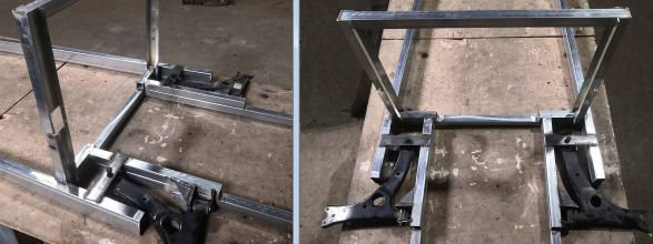

As JE mentioned, I am knocking together a new frame, I want to keep the other car intact and drivable, and already going smoothly.
Will be fast because it's only a modified version of the other car, mostly copying everything over, and not much in the way of any scratch designing, or finding headaches along the way .

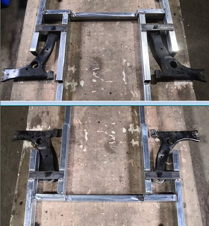

About the biggest change is I am eliminating the OEM crossmember because I don't need it for the steering rack mounts or anti-roll bar, so it's just a lot of weight and wasted money. The lower control arms will hang directly off the frame instead.

One man show, I know, but I really was looking forward to body panels being fitted.
Changing over the the Honda engine made it a "must-do", the frame simply has to be wider, and it's a chance to make some improvements, faster and lower cost.
