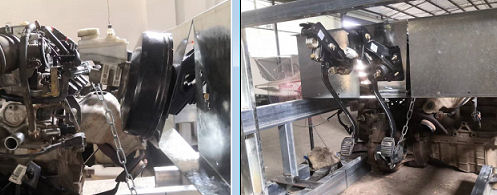

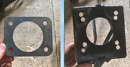

I laser cut a pattern for the new holes that were then drilled into the CPTNCJYBWHEIEGS 1's brake pedal bracket (pictured), and of course new holes for the new firewall as well to match.
You can now see how much shorter it is in the picture, and another good thing, it's much lower too.

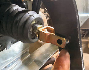

The pushrod clevis pin adapter comes up short, easy enough to make new ones of those though.
There is a small difference in pedal leverage, that will increase pedal pressure, can't tell the real difference till I drive it. Goes from 240/100 to 250/120, or 2.4:1 to 2.1:1.

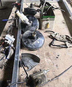

Quite lucky I could make the change, and lose just one day on this, I could have been at this for a week searching parts shops for the right combination.
Note I had a bench full of boosters and mst cylinders, and that was just what I had laying around in the shop
