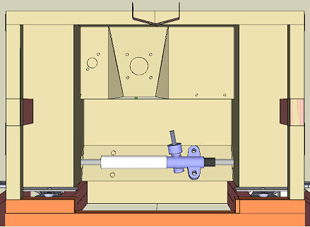

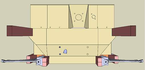

Doing so many little things, but nothing much to directly report, however, the headache of steering has started .. It's the same, but different from the prototype ...

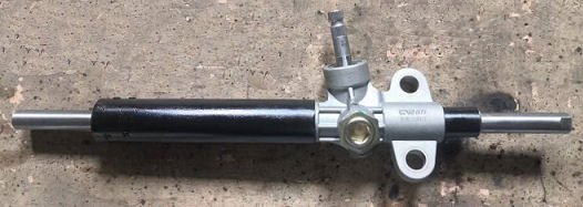

Today stripped down the new rack to make the mod to the rack shaft as I worked out with all the effort on the first prototype, and happy as Larry to find common 'off the shelf' inner tie rod and outer tie rods the right length, also all from the same manufacturer, and even better, the same manufacturer as the front uprights, brakes etc.
So one stop shopping for the bulk of the front end

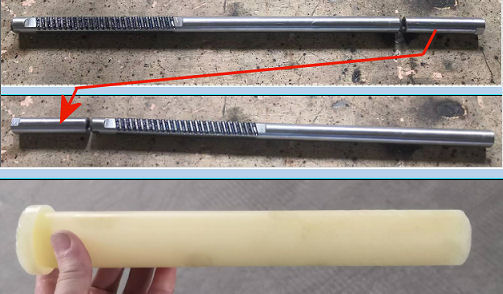

My lathe guy did my steering rack things today.
First is to take 100mm/4" off one end, and add it to the other end.
Second is to turn my nylon bushes, both simple procedures.
Though the rack isn't stock 'off the shelf', due to the central steering position, it is built from a stock 'off the shelf rack', merely modifying it, and the addition of a nylon bush.
Point is, it is not a specialised bespoke built item, and any small workshop with a lathe can achieve the same modifications very easily using the off the shelf rack, not that I expect any significant rack wear in it's lifetime on such a light vehicle with no power steering.
