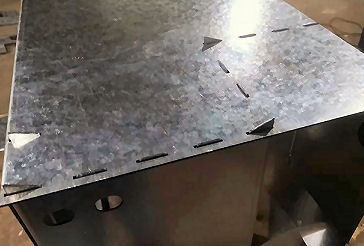

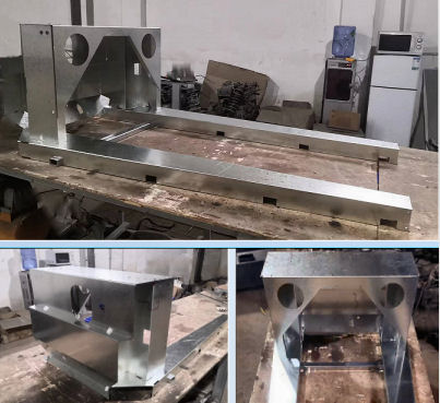

YES! Oh boy, am I happy.
It ticks all the boxes, it just falls together, it just works, it just does, and you're looking at just 6 pieces to create this assembly
I had to take 7 steps backwards to make this very large leap forward, completely worth it!
You can see the tabs sticking through the slots here .. the shark fins are the folding points.
You can see the tabs sticking through the slots here .. the shark fins are the bend points.
Man! That is absolutely awesome and definitely worth the 7 steps back to get this result!! Wow! It even LOOKS cool! Forget the jigs…. Laser, fold and tabs go into the corresponding holes! Heck, even I could help you put a chassis together! Ha!
love it and boy, will it speed things up when you start putting the orders together…. Accurately too! Great job!!
