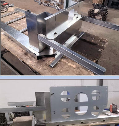

Going together smoothly, added all the floor cross-members and the main front rails.
Did most of the welding myself, as my welding guy was busy and I didn't want to wait 2 days for him, bit ugly but passable, and most are on the inside so you can't see them anyway
Got my template set up for the B-Pillars as you see in the lower picture, so have a look at that tomorrow.
The A-Pillars had 7 tabs on the bottom and 12 on top, I found I only really need 3 on the bottom and only 2 on top, once again CAD computer Vs 'real world', and real world wins.
Got to paint my bench i think, looks ugly in the pictures.

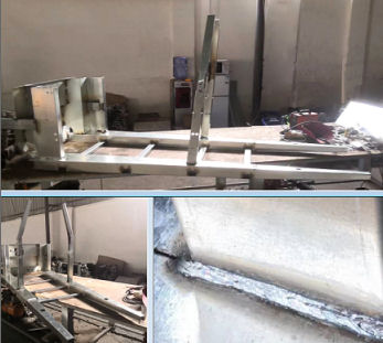

Moving along, lots of welding today, B-Pillars are on, and so are the rear main chassis rails.
Some of my welds aren't too bad, but I'm not going to show all of them, ha! Don't worry, I will never be 'the welder' on production.
Again the CAD computer was wrong Vs real life, the B-Pillars were 16mm or 5/8ths" out, but it's not a problem because I know why, and my real life template, see picture yesterday, did the job of placing them where they belong.
Obviously rollcage is next big item.
