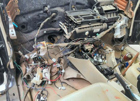

Removing and tagging the wiring loom out of the donor car, in Australia we call a mess like this a "Dog's Breakfast" ...
Thank goodness I am an expert at pulling things apart.
Yes, it's a mess. But, we all know what joy you will have getting it to work again.
I too am an expert of pulling this apart, less so putting it back together though.

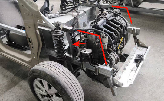

I dislike going backwards, but the upper front rails had to come off, red lines where they were, and bracing substituted, red arrow. I will add a bit of bracing underneath, strength isn't an issue.

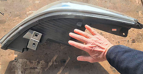

The issue is the massive headlights, I simply didn't think they would be so darn big.
I'm figuring how am I going to do the front bodywork/nose. There's nothing to hang it off, it's a 'Catch 22' situation where I need the nose to make brackets, and I need brackets to make the nose ...
I think I'm going to have to build the nose fixed onto an exo frame, on a trolley on wheels, so I can wheel it on and off the front of the frame into place, while I decide it's shape and size, as well as making mounting brackets.
As Rosanne Rosannadana once said, "It's always something!" Looking good.

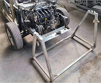

How about a flip up front end?? Many years ago, my sister had a Triumph Spitfire that I would work on. The whole front end was one piece (fenders, lights and all) and it would flip up/forward for great access to the engine, etc.
All of the bracing, etc. stayed with hood, fenders and lights and flipped up. I guess since it was one piece it had some form of bracing/rigidity built in??

This is the idea I mentioned yesterday, a trolley on wheels that will hold the nose with an exo frame (external frame), then I can wheel it in and out as I need while sizing the assembly, and designing mountings for it.
This trolley is a fraction too small to do it.

Below is a picture of the headlight and my hand to enlighten you of how large they are ...
Will the headlights be positioned (height/spacing) and meet all the other FMVSS motorcycle headlight and lamp certification requirements or are changes planned on the Beta Fleet?
