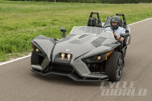

Acimoto headlights appear to simply meet this regulation, the Polaris Slingshot have a a pair or a cluster of inner headlights, that you don't notice really unless this law comes to your intention, clever of them ...

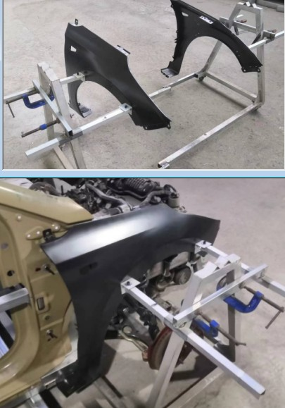

Skyhook
So I got my skyhook together today, quite pleased with it, adjustable on 4 axis, and annoyed it took me a couple of days (casual thinking) to figure out something that turned out so simple.
As you can probably understand, it simply rolls onto the front of the car

The Slingshot holds the answer, 2 legal lights in the middle, barely noticeable, while retaining a normal, 'wide car style' headlamp look, even if it's just the running lights.

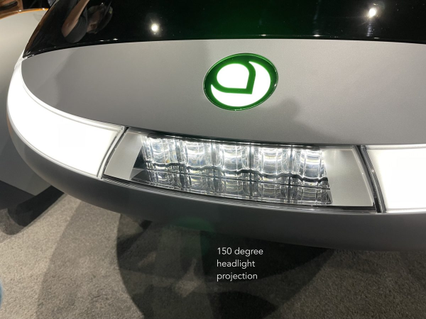

This is what Aptera decided on.

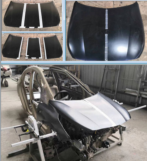

I cut out the middle of the hood today, and used a mesh and rivet bandaid to stick it back together.
Wish I had of put the bandaid on first, because about 1 second after I took the lower picture, the left hand hood half fell to the ground causing a slight dent ...
I am playing with positioning of the panels, not set in stone, so don't get excited either way about it, early days yet ...
