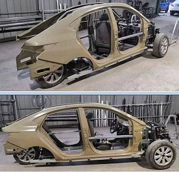

Sleek.
Today the job was to properly affix the sides to the frame so I can build the nose of course. I had to cut sections out of the sides to fit over the side impact bars, I always grimace when i have to cut brand new parts, going to be worse when I have to cut chunks out of the doors to fit. ...
The trolley you saw yesterday that i said was a bit too narrow, well I cut it and widened it to suit, job done, but still trying to figure how to attach the gibsons, I mean the fenders to it so it's adjustable in all directions.
The car looks really sleek in the flesh, the pictures really don't do it justice, going to be a good looking thing i think ....

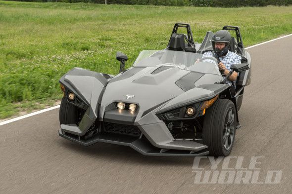

Ok, after much searching, I found it in a law case against Morgan 3 wheelers, see the results below in the link.
The distance from the edge of the reflector to edge of reflector, is 8"
Acimoto headlights appear to simply meet this regulation, the Polaris Slingshot have a a pair or a cluster of inner headlights, that you don't notice really unless this law comes to your intention, clever of them ...
However, the Elio clearly would not meet this law, yet you suggest they changed to suit the law, Vanderhall and especially the Solo comes nowhere near it, makes me wonder what gives with those 2 ...
It's a very stupid law for an Autocycle, and Morgan were right to try to fight it, clearly a bunch of egos in the public service (what a shock) stuck to their guns, idiots.
I can't afford to go to Court and fight it, so I need to figure something clever to get around it, Slingshot solution looks the way to go, people can change back to the 'normal' headlights later.
